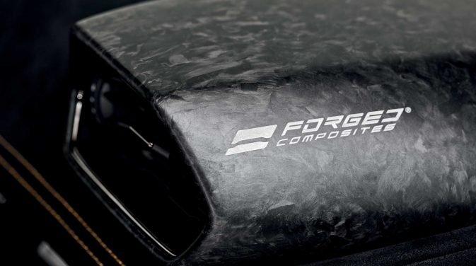

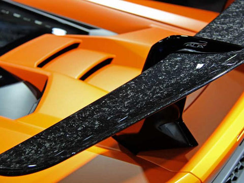

Forged Composite starts off as a sheet of uncured plastic, and is mixed with short randomly placed carbon fiber strands. Unlike traditional carbon fiber sheets, this material does not require careful cutting and precise laying into molds. Once the right mass has been cut and placed into a hot press mold, it is squeezed under high pressure, heated, and voila! — You have an object that is as light and stiff as a traditionally created carbon fiber object; only this one is produced in minutes instead of hours.[4]
